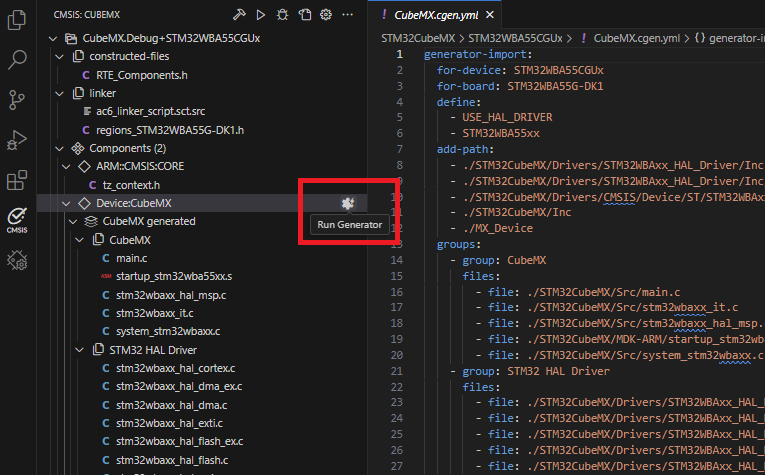

Usage in VS Code
The VS Code Arm CMSIS Solution extension lets you run CubeMX from the CMSIS Solution View.
  • In the dialog Create New Solution choose a device or board and select a CubeMX template (which contains the Device:CubeMX component).
  • Use Run Generator that is available for the component Device:CubeMX in the CMSIS Solution View. This starts CubeMX and once the configuration is complete, click in CubeMX the button GENERATE CODE. The generated code is imported with file CubeMX.cgen.yml as shown below.
VS Code - CubeMX Integration

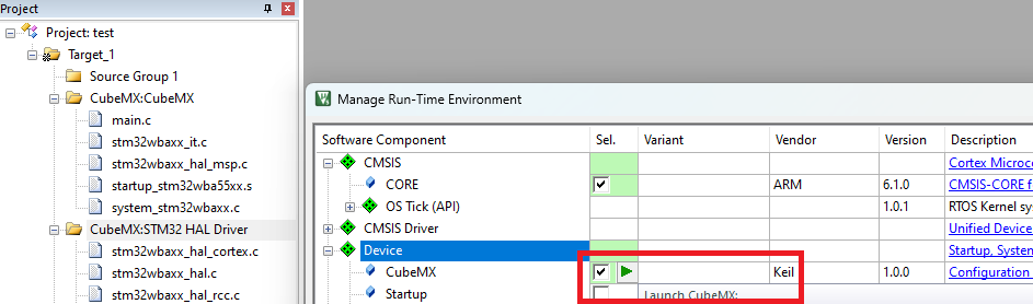

Usage in uVision
The uVision lets you run CubeMX from the Manage Run-Time Environment Window.
  • Select a device and enable in the Manage Run-Time Environment Window the components:
  • CMSIS:CORE
  • Device:CubeMX
  • Use Launch CubeMX that is available for the component Device:CubeMX in the Manage Run-Time Environment Window. This starts CubeMX and once the configuration is complete, click in CubeMX the button GENERATE CODE. The generated code is imported with file CubeMX.cgen.yml.
uVision - CubeMX Integration
