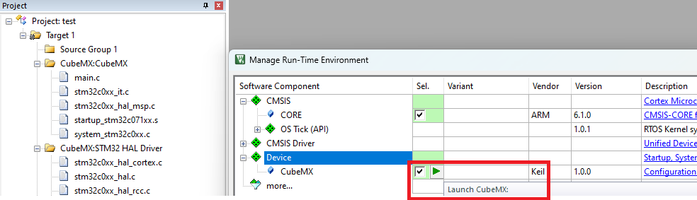

Usage in uVision
The uVision lets you run CubeMX from the Manage Run-Time Environment Window.
  • Select a device and enable in the Manage Run-Time Environment Window the components:
  • CMSIS:CORE
  • Device:CubeMX
  • Use Launch CubeMX that is available for the component Device:CubeMX in the Manage Run-Time Environment Window. This starts CubeMX and once the configuration is complete, click in CubeMX the button GENERATE CODE. The generated code is imported with file CubeMX.cgen.yml.
uVision - CubeMX Integration
